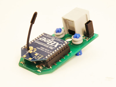

I have a pair of Dexter NXTBees and am having a few software issues in regards to using NXC with them.
After a lot of Protocol relate issues between NXTBees & the NXT initially which was followed by a lot of brainstorming with Xaander and Dexter Industries. That issue has now been sorted.
I there a reason why data exchange between the two Dexter NXTBees, will only work in RS485 Raw Mode? This makes for cumbersome programming.
Dear 'John Hansen', is it possible to have the RS485 Communications mimic that of the Bluetooth Mailbox Protocol?
I've found the NXTBees to be very frustrating too this point in time. They show great promise, but the programming needed to use them successfully is giving me a major headache.
Has anyone else managed to master the NXTBee communications between a pair of NXTs with NBC/NXC or any other language?
