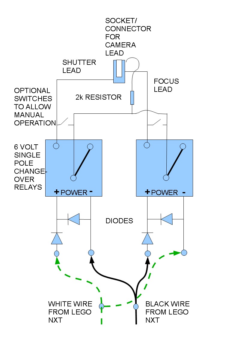

I don't have the mindstorms set yet, so this may be a trivial question, but I am wondering wether it is possible or not to control an output switch from within the program. My idea is to control the shutter of my Canon SLR which uses a proprietary connector:
Provided I make the cable between the N3 connector and the NXT, is it possible to program this simple switch? I have googled much but couldn't find much about output that wasn't related to motors. I found many "automatic light switch" bots but that relied on mechanical means to actually activate the switch.

I have used this arrangement :-
(79.88 KiB) Downloaded 72 times
Use onfwd command to select one relay or onrev for the other followed by wait then off to stop the current and release the relay (non-latching of course).
Bit of a guess as to the wait period for focusing since you don't know how long the camera will take. I am using 2 seconds at the moment. I allow 0.25 seconds for the shutter and that seems to work (so far!).
The relay voltage should be between 3 & 6 v imho since a 9v relay might not be reliable once the battery runs down.
You can use the batterylevel command in NXC or Guy Viv's NXT-G battery level block to find the actual voltage at any time. Then factor it down to get the motor power setting by 100*relay voltage/actual voltage. I reckon there will be a voltage drop of about 0.7v across the diodes so set the relay voltage at 6.7v for my 6v relays.
Any single pole non-latching relay should work but I have read that reed relays can affect each other if too close so I avoided these.
The remote cable I bought had no resistor in it, just a simple switch but I added one just to be on the safe side.
There is a ready-made version available at http://www.techno-stuff.com/relay.htm

Thank you for your very fast and thorough answer. My intention was at least to have shutter control, but focus can of course be useful.
So indeed there is no native way to do this with just the starter kit. I had seen the relay block you mentionned, but it seems a bit pricey (+s&h), so I guess I'd rather assemble your solution myself. Did you use the ready made relay, and if not, could you give me a hint as to which components you actually used?
Re: Question about output switch
Basically, whatever was cheapest on ebay!
Bought a pack of 5 SRD-06V-DC-SL-C spco relays for about £5 - £6 and there are similar units on there at the moment for about the same price. There is no reason to use identical relays for both halves of the circuit as long as you remember to factor the power going to each relay. For instance, if you have a 3v and a 4.5v relay already you can use them. The code I showed earlier has different variables for focus_power and shoot_power to accommodate this situation.
I splashed out on the diodes, going for a pack of 50 1N4004s when 1N4001s would have done but, hey, you only live once!
The 3.5mm stereo audio socket I had already and I initially adapted the cable from the remote release I bought (ebay of course) but now use a ready-made 3.5mm - 2.5mm stereo cable bought for £1.99. Looks better and has a 90 degree bend on the plug at the camera end. Push buttons were just standard push-to-make cheapos. Not really necessary but it means you can use it as a standard remote if you want. The original remote I bought had a straight metal to metal connection but I added a resistor just to limit the current from the camera.
For the first one I butchered a plastic case for holding 8 AA batteries. When I knew it worked I made a new one using a Vero board and for this I modified a plastic box which used to hold a pair of cuff links. As a Scot, I prefer to use what is lying about rather than buying something new. Wouldn't bother with the pcb next time though, just wiring it and using heat-shrink tubing to hold it all together works fine.
Both circuits are identical, you just connect the white wire to relay positive on one side and the black wire to relay positive on the other. If you don't want focus then just build one side.
The socket is wired with the shutter relay connected to the tip of the plug on the cable, the focus relay to the middle band and the common to the main body of the plug. I use a Canon 400D so it should be the same for yours. It is easy enough to test, plug a cable in and short out the elements on the plug at the other end to see what happens. I used a socket because I have a Fuji with a different type of connector at the camera and need to switch cables. If you are only going to use one camera you can solder your cable straight onto the relays.
The cable to the brick is a short NXT cable cut in half. Extensions were connected to the black and white wires and led to the circuit in the case. The other end goes into one of the motor sockets on the top of the brick. The unused wires were cut to different lengths and sealed with heat-shrink tubing to avoid the possibilities of shorts which might damage the brick. The b & w wires originally went to the motors and the current flows one way to drive the motors forward and the other for reverse. Voltage is varied to set the motor power and can be up to 9v, which is why you have to factor it to avoid burning out the relays.
Since this just uses a very simple command to run the motors, I don't see any reason why you could not operate this circuit with one of the old RXC units instead of an NXT. If I am wrong then no doubt I will be corrected very quickly!
Hope this helps.
PS - I noticed that the commercial product (which uses a very similar circuit) includes a 220 ohm resistor on the brick side of the circuit, presumably to limit the current being drawn from the brick. I did not consider that because the relays I bought only drew a small current and the diodes offer some resistance but it might be something to think about.

thank you, this is very helpful. Actually, I have a canon 7d so the socket is different from an audio jack, it's a N3 connector. There are cheap chinese remote controls on ebay from which I could get the female connector. With your information, I think I can actually pull this off.
