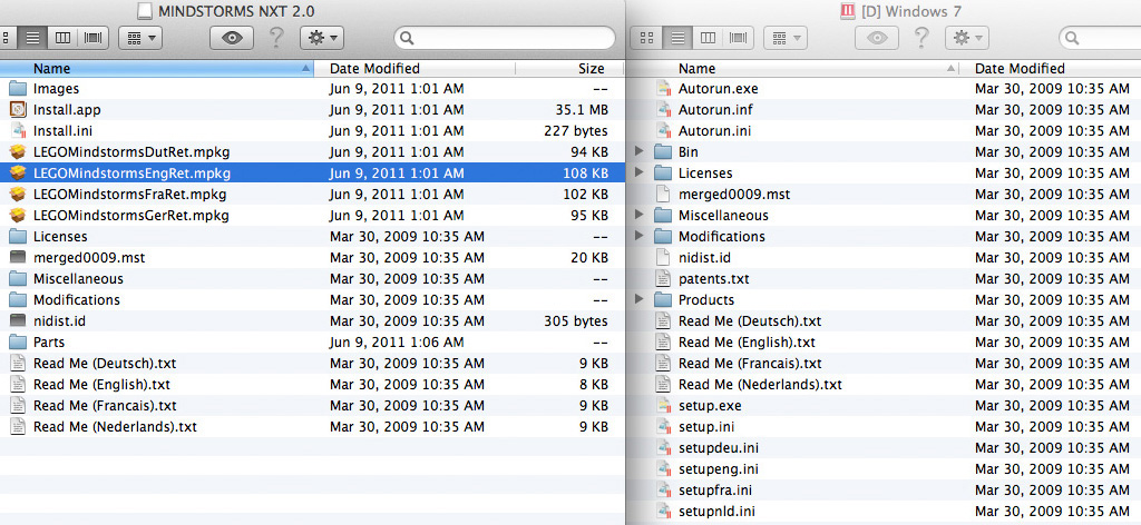

The Mac files for some reason are simply missing from my DVD. When I examined the DVD files on my PC I could find ZERO Mac (.pkg or .dmg) files.

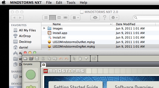

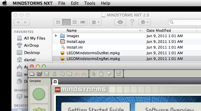

Success with installing on Mac OS X - Lion, after following this:
1) Download the ISO file, double click to open
2) Don't click the Install.app file instead click LEGOMindstormsEngRet.mpkg
I'm still miffed and amazed that Lego shipped a DVD in my kit that had NO Mac files on it at all.

FYI, here's a comparison on the left-hand side showing the files and folders from the Lego download link and on the right-hand side the DVD that shipped with my MINDSTORMS NXT 2.0 kit:
