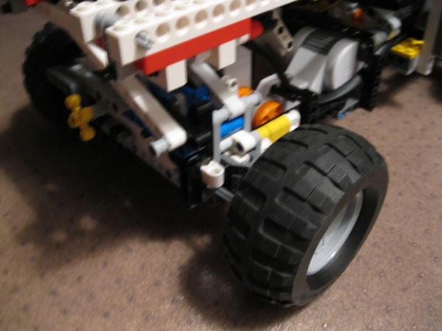

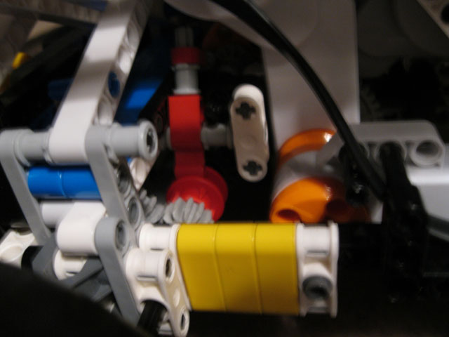

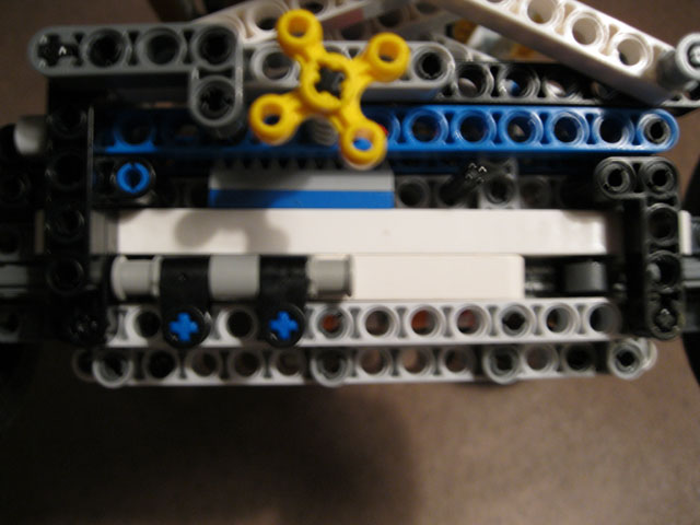

Here are a few pictures I already have (I don't know where the camera is to take better ones).
