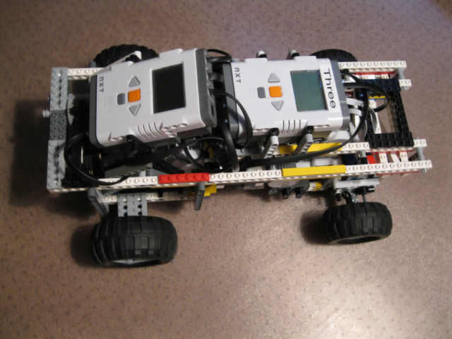

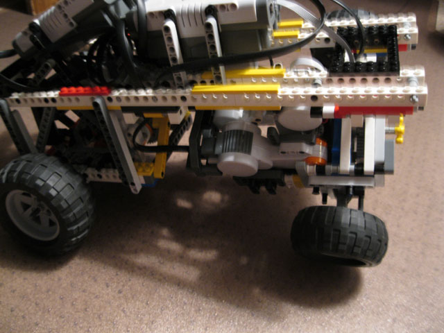

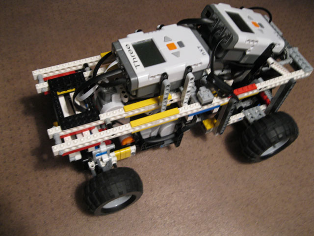

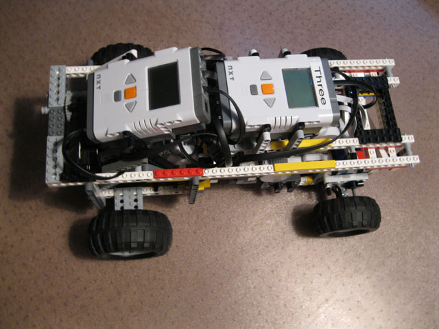

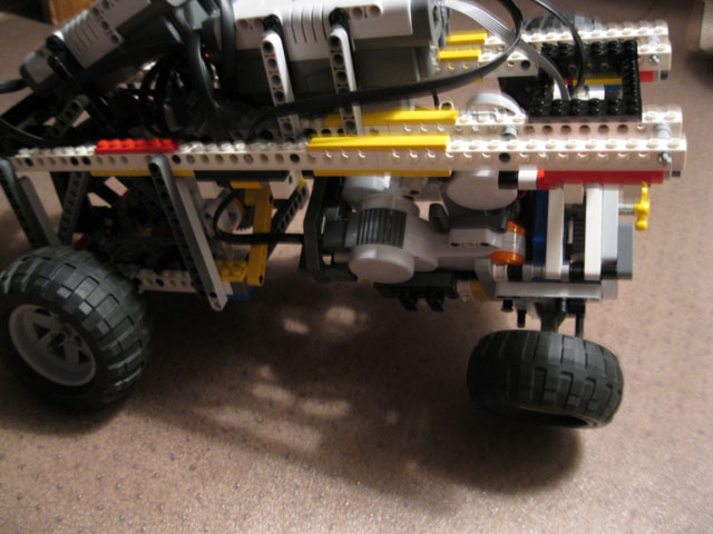

Here are some pictures of it:

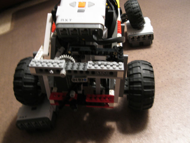

The front assembly:
Note, there is a 3 attachment limit per post, so I plan to make another post (or two) for some more pictures.

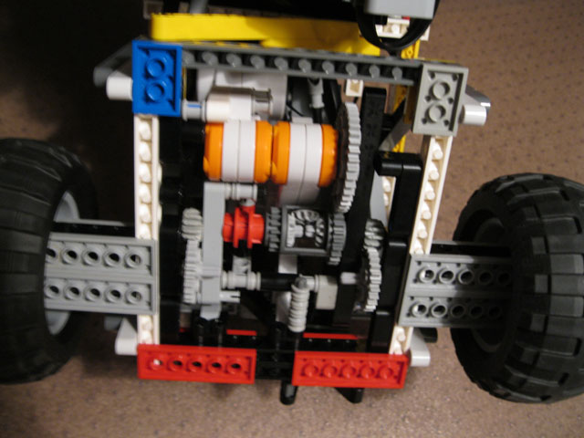

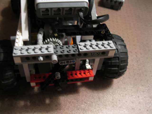

Here is a picture of the rear gearing, and differential locking driving ring.

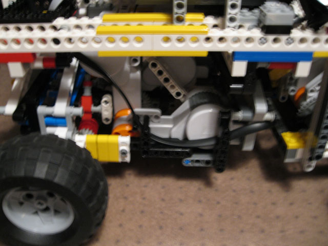

Here is a picture of the front gearing, and the differential locking driving ring.

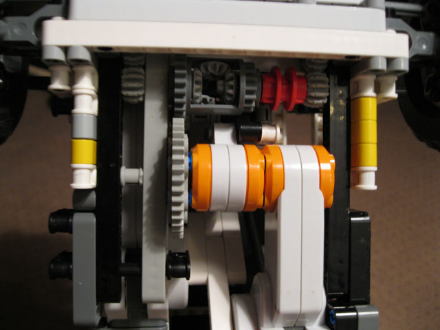

Here is a picture of the back, showing the rear differential locking mechanism the motor uses to lock/unlock the differential.

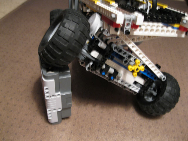

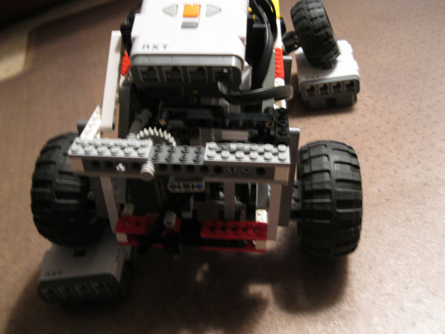

Here is a picture of one of the front wheels resting on an NXT:
Here is a picture of it with the other front wheel on the NXT:
This picture shows it resting on two NXTs:
The vehicle is powerful enough to drive up the wall until it is totally vertical (coming from an angle, so the front wheel "grabs" the wall). It can drive up and over a 3-5 inch (10-16L) vertical stone side with no trouble. It can roam across a pile of 1" wood cubes.
