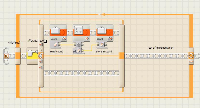

What I'm trying to do is this:
while (true)
if (condition)
counter++
[rest of implimentation]
The problem I am having is putting the added value back into the same variable that is being read. I might not be explaining it well, but I hope you understand what I am trying to get at. Thanks again for the help.
Re: NXT Counter
You have to set the block to write, so that there is an input wire.

Re: NXT Counter
Something like this?
You will need to edit the "Switch" (read: if statement)
to reflect your custom condition and add your code ;)
The math block does not write to the variable straight away, but stores it in a "data wire" (read: temporary variable)
which is used by the second variable block, that writes to the variable
