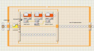

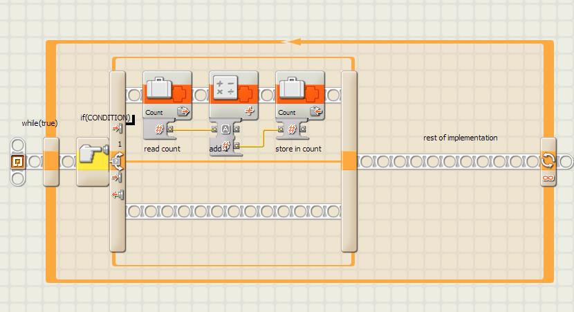

Re: NXT Counter
Something like this?
You will need to edit the "Switch" (read: if statement)
to reflect your custom condition and add your code
The math block does not write to the variable straight away, but stores it in a "data wire" (read: temporary variable)
which is used by the second variable block, that writes to the variable
