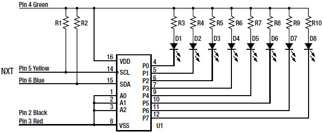

I'm trying to control 8 leds using a PCF8574 according to the scheme as seen in the attachment (from the book NXT Extreme).
The problem is that I can't control the leds. If I connect the PCF to the NXT only 4 leds are turned on continously (the leds connected to P0, P1, P2 and P3) and the other 4 leds are all off. I tried multiple software programs like NXT-G or NXC but I can't switch any leds on or off. It also doesn't matter which port I use (sensor port 1 to 4 or motor port A, B, or C) while I only programmed to control the PCF by sensor port 1.

Are you wiring it up using discrete parts or using a ready-made board?
If using a commercial board, have you set the jumpers to enable the pull-up resistors?

I use discrete parts. I bought a PCF8574AP fabricated by NXP: http://www.nxp.com/documents/data_sheet/PCF8574.pdf and got some leds, wires and resistors from my work. I soldered it all together on a standard solder board (similar like: http://itp.nyu.edu/physcomp/Tutorials/S ... APerfBoard).
I have no idea what you mean setting the jumpers to enable. Could you explain that a bit further?

I'm dry... what bothers me most is the 4 LEDs continuously on. Are you sure your IC is not fried?

That can happen, but it's quite rare. Stupid question: are you sure the IC is not upside down?brandts wrote:In not sure that the IC is fried. Is it possible that I damaged something inside the chip with soldering the contacts?

Have you tried changing the port address in case you have bought an 'A' model chip?
"#define I2CAddr8574 0x70 // I2C address x040 8574 or 0x70 for 8574A"
If you tried it in a motor port it is possible that the extra voltage available (9v cf ~ 4.5v) has damaged your chip since it operates between 2.5 & 6v.
