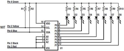

I'm trying to control 8 leds using a PCF8574 according to the scheme as seen in the attachment (from the book NXT Extreme).
The problem is that I can't control the leds. If I connect the PCF to the NXT only 4 leds are turned on continously (the leds connected to P0, P1, P2 and P3) and the other 4 leds are all off. I tried multiple software programs like NXT-G or NXC but I can't switch any leds on or off. It also doesn't matter which port I use (sensor port 1 to 4 or motor port A, B, or C) while I only programmed to control the PCF by sensor port 1.
Can anyone tell me what I'm doing wrong?

I use discrete parts. I bought a PCF8574AP fabricated by NXP: http://www.nxp.com/documents/data_sheet/PCF8574.pdf and got some leds, wires and resistors from my work. I soldered it all together on a standard solder board (similar like: http://itp.nyu.edu/physcomp/Tutorials/S ... APerfBoard).
I have no idea what you mean setting the jumpers to enable. Could you explain that a bit further?
I tried the program from the book (which I believe is NXC instead of NBC) and also tried the NXT-G software which I downloaded from www.mindsensors.com
