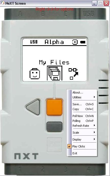

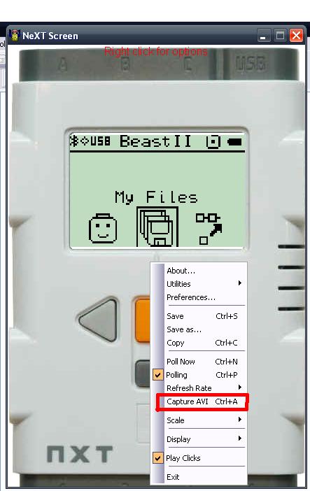

Can't you just use the Capture AVI feature in NXTScreen

What capture AVI feature?

Try upgrading nxtscreen/bricxcc
Which one are you using.
