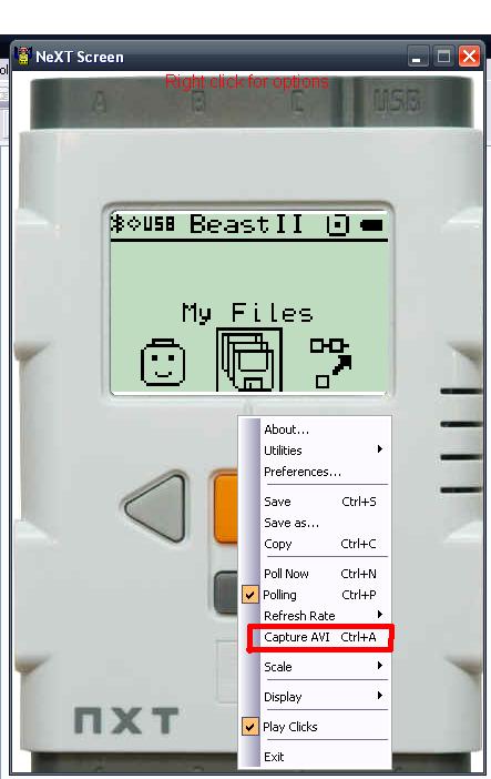

Re: Display Time Block Bug
Can't you just use the Capture AVI feature in NXTScreenstudbrickmaster wrote:I have attached a video made with NeXT Screen and Hyper Cam 2, and the test program.
What capture AVI feature?timpattinson wrote:Can't you just use the Capture AVI feature in NXTScreenstudbrickmaster wrote:I have attached a video made with NeXT Screen and Hyper Cam 2, and the test program.
studbrickmaster wrote:What capture AVI feature?timpattinson wrote:Can't you just use the Capture AVI feature in NXTScreenstudbrickmaster wrote:I have attached a video made with NeXT Screen and Hyper Cam 2, and the test program.
Try upgrading nxtscreen/bricxcc
