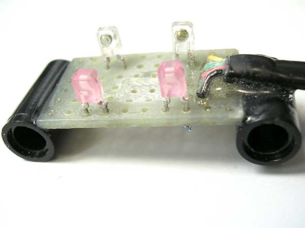

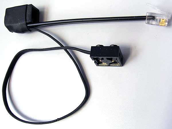

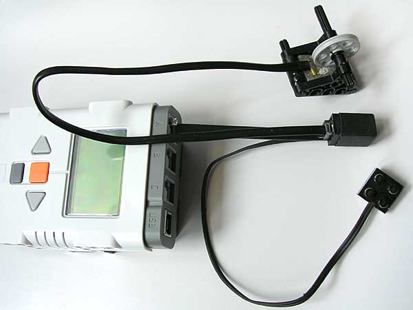

If you dare to do some electronics tinkering, here is an old attempt I did, that worked fairly well (but I never wrote up about it). It uses ball mouse encoder components and a LEGO wedge belt wheel. The schematics is more or less the same as NXT internal motor encoder. A Y split cable allows to use an unencoded motor at the same time as the encoder.

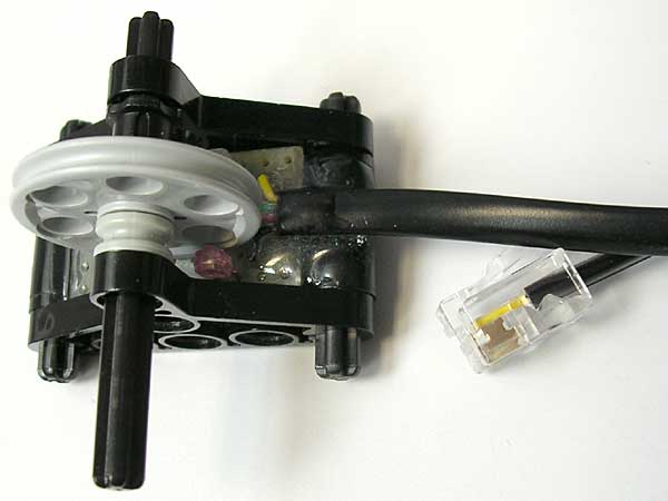

The final image...
One drawback of this setting is that the open frame construction makes it somewhat sensitive to ambient light. The resolution is also limited, to 12 ticks per turn.
