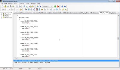

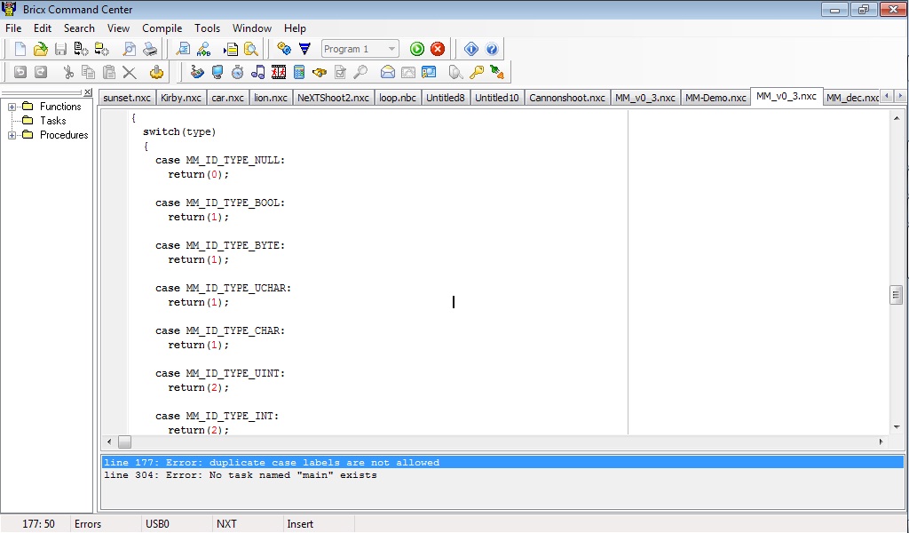

There is an error saying "duplicate case labels are not allowed" on line 177.
Here's a pic:

@nxtboyiii Thanks for that bug fix.
The fixed code is attached.
