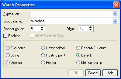

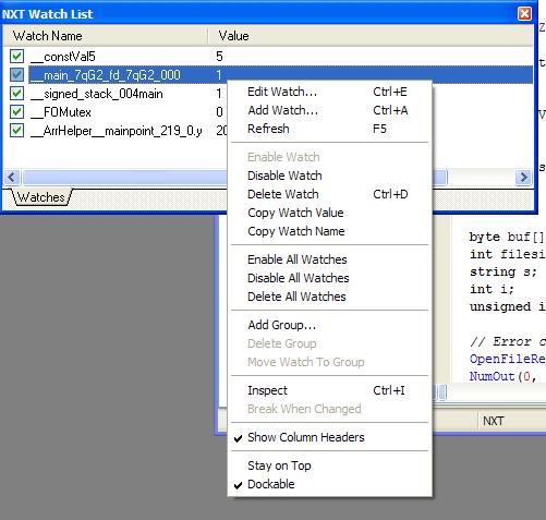

In BricxCC you can watch variable values but the debug features are not as complete as what you get with RobotC. I have started implementing program pause and single step support and break points but that still has a long way to go to be fully featured and iron clad. These kind of features require the enhanced NBC/NXC firmware since the standard firmware has no support at all for pausing/stepping through a running program.
BricxCC has several tool windows which aid you in programming/interacting with an NXT robot. The NXT Screen lets you view on your PC what is drawn to the NXT LCD (either the normal or the popup screens) and grab screen captures or movies from the LCD. The NXT Explorer lets you drag and drop files between your PC and your NXT as well as deleting/defragmenting/running programs/stopping programs/playing sounds, etc... The Brick Joystick tool lets you control the NXT motors via mouse, keypad, or joystick/gamepad. The joystick buttons can be programmed to run Pascal scripts on the PC which control the NXT via direct commands. The Pascal scripts can be edited via the IDE and run with pause and single stepping in the IDE editor window. The Remote tool gives you fine-tuned control over motors with user-definable program button actions (right click to set which program the button launches). The Direct Control tool window also lets you turn motors on (in either direction) or off and control the power level. Additional tool windows in BricxCC include a Diagnostics tool which shows information about the NXT including the battery level, firmware version, free flash memory, running program name, NXT name (editable via double click), and bluetooth mac address. The Brick Piano lets you write simple melodies which can be saved in several different formats and replayed on the NXT. The Send Message tool lets you send any kind of message to any mailbox on the NXT. The MIDI and Sound conversion tools let you create NXT Melody files (RMD) or NXT Sound (RSO) files for playing on your NXT via the PlayFile API function. And there are 3 different ways you can watch variables in a running program: Watching the Brick, Configurable Watch, and the new not yet released NXT Watch List tool. Here's a preview of the new NXT Watch List tool:
