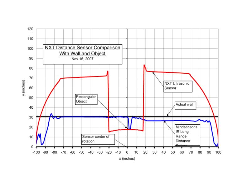

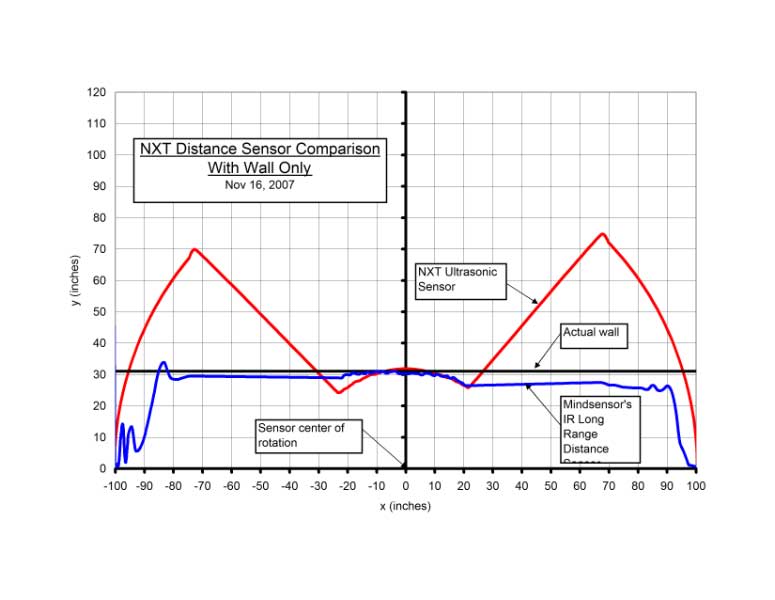

Hello,
A while ago I did a comparision test of an ultrasonic and infrared distance sensors. Each sensor was mounted to an NXT device about 30 inches from a wall. One test was done with the wall only. Another test was done with a rectangular block of wood about 10 inches away from the wall and 20 inches from the sensor. The block of wood was about an inch wide (in the direction of the scan). A slow scan was done with each sensor. Distances and angles were saved to a file and graphed in Excel. The resulting graphs are shown in the attached pitures. From the graphs it would appear that the ultrasonic sensor has about a 90 degree "field of view".The infrared sensor had a much narrower fleid of view.
Certainly the best choice will depend on the application. Hopefully this information will help to make a more informed choice.
Dave
Dave
- Wall only
- Distance without object.jpg (63.78 KiB) Viewed 22268 times
- Wall with object
- Distance sensors.jpg (65 KiB) Viewed 22268 times

I'm having a bit of trouble interpreting your results. Could you provide us with some more information about your test layout?
Why did the US and infrared range drop to 0 at 90-100 degrees?
Why did the US range have the peaks at 70 inches without the block but plateaus at 70 inches with the block?
Why didn't the US see the wall at all when the block was in front of it?
What was the infrared sensor seeing at 30 inches or was that max range?

The sensor's center of rotation was at X, Y coordinaters of 0,0. The scan was started at 90 degrees left (pointed along the negative X axis) and went to 90 degrees right (pointed along the positive X axis). The sensor would rotate and stop in two degree increments. After being stopped for two seconds it would save the current distance reading to an array. So the program gave two arrays: One for angles and another for distance readings. Those arrays were saved to a file and put into Excel. The angles and distances were converted to X,Y coordinates and plotted -those were the graphs in the initial posts for this topic.
So when the ultrasonic sensor was pointed 50 degrees left of the Y axis, it was reading 100 inches (-75,65 in X,Y).
When the ultrasonic sensor was pointed 40 degrees left of the Y axis, it's reading was about 33 inches (-20, 26 in X,Y).
I hope the above description answers most of the questions. If not, let me know. Below are a couple answers to specific questions.
The IR sensor is not as sensitive to slanting of the measured surface -from the graphs it first detected the wall at about a 20 degree angle.
Dave
The US sensor returns the closest object it detects. Since it's field of view is roughly 90 degrees (45 degrees per side). It first detected the block when the sensor was pointed at 45 degree left of the Y axis. It stopped detecting the block when the sensor was pointed 45 degree to the right of the Y axis.Why didn't the US see the wall at all when the block was in front of it?
The sound does not get a strong reflection from a soft object. The ir sensor is measuring the reflected energy from an infrared light -so the hardness or softness of a surface does not matter. -I understand (but haven't tested it) that highly relfective surfaces (like a mirror) can cause it problems.Two of the main problems I've run into [with the US sensor] is that it can't see soft objects (absorption?) and it can't see flat surfaces that are slanted away from it (specular reflection?).
Dave
