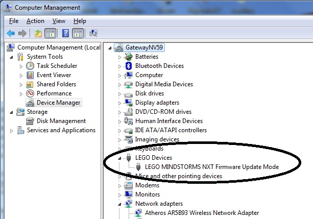

If you search Google you will find it has been a very big problem for many people for a long time! Some even had to return their bricks to Lego to get them sorted.
I tried both the NXT-G and Brick Center several times but neither could connect to the brick. Tried restarting the computer, resetting the brick, deleting then adding the brick back in through the devices manager but to no avail.
The problem is that Win 7 could not recognise it. First time I tried it was added, but as a digital camera! Perhaps it was confused by the screen, thinking it was a lens............ Later it just came up as 'unidentified', presumably because it was not supplying the signals that the OS expected. Since Windows could not identify the device type, it 'switched it off', thereby preventing any programs from finding it.
I then dusted off my ancient Dell laptop, which runs XP. Connected up first time & managed to get the Lego 1.29 firmware re-installed.
