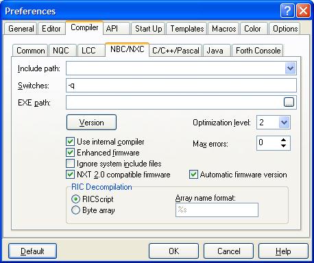

The SetSensorColorFull gives an error "unidentified SetSensorColorFull". What to do?
B2O productions are the best for the best.
Re: Programming the Lego Colour Sensor in NXC
Get the latest version of BCC.
