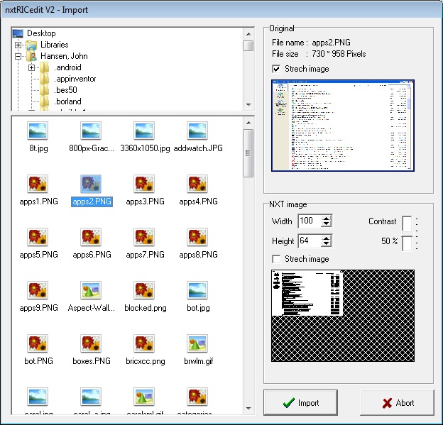

Re: [RIC] Converting Images to NXT Picture Files (.ric)
I have been trying to import pictures into riceditv2 to create a sprite but without success. I have tried different formats and colour modes but no pictures show up to be selected, just the directory tree. I had it working on my last computer but the new one is running Win 7 Home Premium 64 bit. Using the compatibility wizard and running it as administrator have not made any difference.
Is anyone else running it under Win 7?
