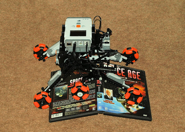

I haven't checked out Mindboards for quite a while and I'm glad I did. It's an amazing coincidence that I've been working on the same project.
My Mars Rotacaster Rover uses my favourite wheels, the amazing Rotacaster Omni-wheels for unsurpassed manoeuvrability in confined spaces.
I've had a few attempts, going back to the days of my LEGO Mindstorms RCX Kit to build a working Mars Rover that had the same suspension system. They all failed for various reasons, including steering the front and rear powered wheels. Also I was probably making the whole drive-train far too complicated, which introduced lots of reliability issues.
The project is still evolving, with the removal of the 'Shock Absorber" Supports to the chassis. I now use a Hitechnic Acceleration Sensor in conjunction with an NXT Motor to make the chassis self levelling, independent of the 'Rocker-Bogie' inclination...
More information on the project is available at www.rjmcnamara.com.
