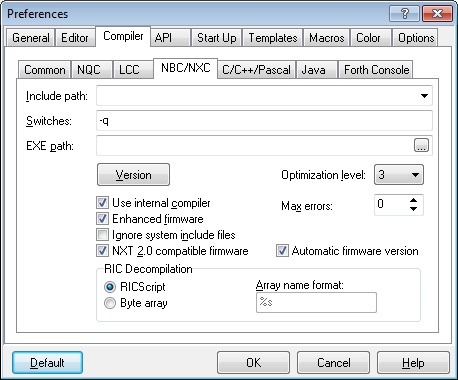

With the version of BricxCC/NBC that I have (not released either as a test or official release yet) I do not have a 0 value returned by ArrayLen. So I packaged up what I have into a new test release and uploaded it to sourceforge. Please try this out - along with the new firmware in the zip - and let me know if you still have problems:
http://sourceforge.net/projects/bricxcc ... 111024.zip
I will put this up in the test release folder this evening, i.e., at http://bricxcc.sourceforge.net/test_releases/.
A full official release of NBC 1.2.1 r5 and BricxCC 3.3.8.10 should be ready by the end of the month, if not sooner.

I have also tested the above program (with the change to the print function) using the BricxCC test release dated 2011-07-20 and it works fine for me with that version. So can I please see your NBC/NXC options from the Preferences dialog?
Perhaps you are not using the internal compiler or a different optimization level?

Yes, optimisation level was 2, and I don't use -q (NXT doesn't beep on successful download?). Those were the only differences.
So I experimented with different optimisation levels:
0: ArrayLen displays different number each time - always a multiple of 8.
1: Same as 0.
2: ArrayLen always displays zero.
3: Same as 2.
4: Same as 2.
5: Same as 2.
6: Same as 2.
All other compile options are identical, so there must be something else different here.
