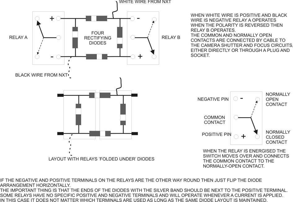

It can be done from a sensor port using I2C or from a motor port using relays (one if you just want shutter control, two if you also want to set the focus).
Mindsensors relay driver can be used to control both, as can the module from Techno-stuff.
http://www.mindsensors.com/index.php?mo ... AGE_id=140
http://www.techno-stuff.com/relay.htm
If you want to build your own you need one 9v relay and one rectifying diode (1N4001) for each function.
You can also use a transistor as a relay.

Thanks a lot for the schemes, h-g-t!
My electronic skills are not the best, but this seems to be quite easy. I will try to build it my self, instead of buying mindsensors' relay or technostuff one. Just because it increases the cost. If the cost is reasonable, I design a little PCB.
