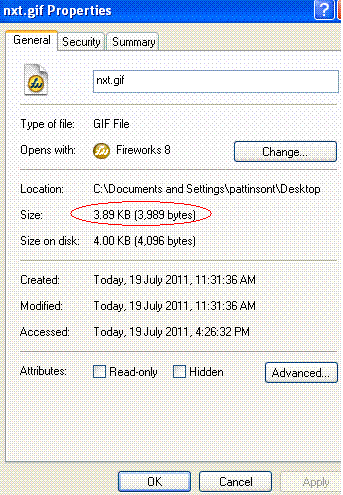

very impressive, this again proves: 1 picture says more than 1000 words (1 word= 4 byte)^^

doc-helmut wrote: 1 picture says more than 1000 words (1 word= 4 byte)^^
:lol: :lol: :lol:
Thanks for taking time to improve my code ;)
EDIT: 3989/4
= 997.25
So close ;)
