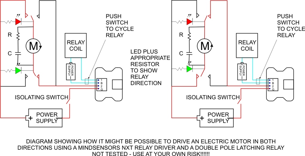

Although the driver can operate two motors at variable speeds but only in one direction, I think it should be possible to operate a single motor in both directions using a latching double pole relay.

I have attached a possible layout for consideration. The relay could be driven from the same power supply as the motor using a voltage regulator.
Some latching relays need a set and reset pulses on separate pairs of wires. Others use only 2 wires but the pulses have to be in different directions. The type needed here is a 2- wire uni-directional pulse model. Also called a sequencing relay. Whatever you call them they tend to be expensive!
