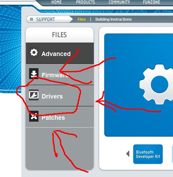

Perhaps you should check that you have the latest Lego Fantom driver, available at
http://us.mindstorms.lego.com/en-us/sup ... river.aspx
zemata
Posts: 11
Joined: 22 Jul 2011, 06:16
Re: Bluetooth troubles in NXT-G
Post by zemata »
Yeah none of this helps. Of course I have bluetooth turned on on the NXT brick and the drivers you linked me to are firmware updates for the brick it says.

The second link is the exact one that I bought. Are there specific drivers I need to have it work well with mindstorms? This is so frustrating!
zemata wrote:Yeah none of this helps. Of course I have bluetooth turned on on the NXT brick and the drivers you linked me to are firmware updates for the brick it says.
zemata
Posts: 11
Post by zemata »
Ok guys thanks for the advice. Just popping in one last time to say it's working now. I can get into my brick wirelessly from NXT-G :D. My problem was after I installed the latest drivers, I didn't try connecting from NXT-G, but I kept trying to connect from the brick!
