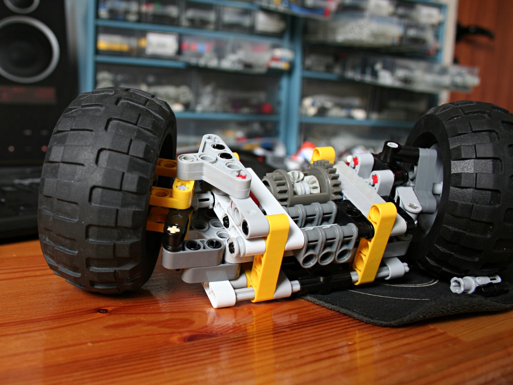

I have finished the steered pendular suspension module now. I redid the body, simplifying the construction a little and improving the connection with the steering knuckles.
In the old design the 24 tooth gears could touch some other parts when the construction was applied horizontal pressure. (It would not stop the gears though.) More space was given here so that the gears will always run smoothly.
I added connections for suspension. I will connect the spring to it with a 2-3 stud long beam, this prevents it from getting to close to the gear and allows free movement in the other direction.
The steering is just like Sariels design. It doesn't run that smooth though, I think the 16 tooth gear is pressed too tightly against the gear rack. So I might change this to a 8 tooth gear and add a 1x4 plate underneath the gear rack. This runs more smoothly iirc.
I took a few pictures while building the back module (which is just rotated 180 degrees), I can upload them if anyone is interested. I took them so it would be easier to make a CAD later on, so while rough it might be enough to recreate the design.
Next task is to build a pendular module for the center wheels. It will be 5 stud long instead of 7 and the drive axle will of course go all the way through this time. The reason it did not in steered module was that I stabilize the 24 tooth gear by letting its axle go all the way from one side to the other (and thus blocking the drive axle). To improve the stability in this module I will move the gear (and the differential) one stud outwards and have a beam in between the 24 tooth gear and knob wheel.
I will not add any connections to springs, actually I will make it possible to lock it to prevent it from moving at all. This way I can try both the spring less solution and the one with springs on the front and back wheel pairs.

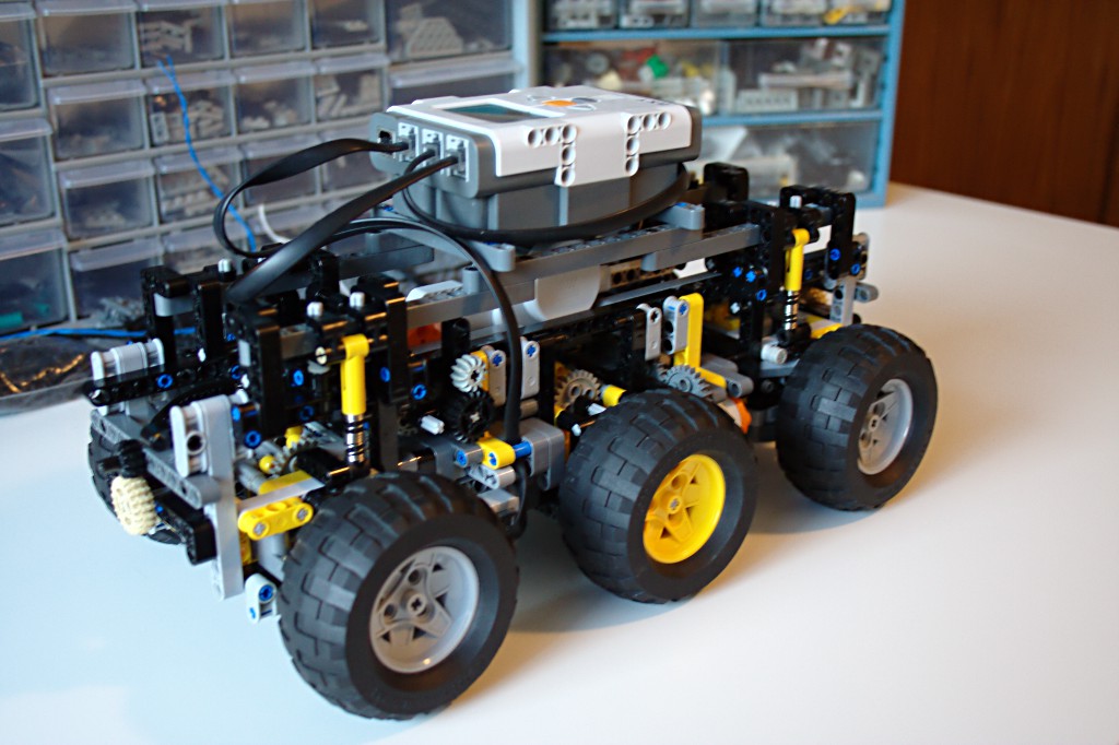

I finally have an Internet connection at home so here is what I have after nearly 1½ month. Which is about 5-7 hours of work later I guess... I'm quite ashamed I haven't done more than I have considering how much time has passed.
I finished the chassis along with the motor for steering. Even with the NXT placed on the very top, the center of gravity is low because the way the motors are placed. While this is great, I'm a bit worried about clearance...
Adding suspension is a first for me, so getting it right was a little tricky. The length of 5.5 was also a bit annoying but it worked out. I didn't want to place the springs vertically originally since I want to keep it low, but mounting them diagonally didn't quite work out. I will later try to place the horizontal beam on the outside instead of the inside, I should be able to place the NXT in-between the springs that way and reduce the height.
The way I planned to connect the springs so that the wheel could move downwards without being limited by the springs length worked just like I wanted.
I'm currently interested in how the center module will perform. As you suggested earlier, using some sort of independent suspension for the center axle might be better, not because of slopes but because of the way it is lifted off the ground when the front or back axle 'twists'.
I want to do actually do some testing before redoing anything though.
So my next goal is writing the software. My goals are:

I think it looks good as is
and I like the drop-out linkage on the suspension. Reminds me of what I've seen used for elliptical (leaf style) springs on some rock-crawlers.
Also I just thought of something, if you did use some type of suspension on the center module you could potentially lift the center axle off the ground. At that point you would have just the front and rear tires contacting the ground. This could be interesting if you managed to shift the steering to a crab mode, and drive the vehicle diagonally for a short distance.
Good luck with the programming, I'm good at the hands on part, not so much on the programming. However I did manage to (using the NXT-G software) create a small group of programs, which would accelerate/decelerate 5% at a time and then loop those programs to reach the desired speed. With a small time delay between the loops and some gentle tuning you can mimic a ramp up/down of larger PWM speed controllers that use "soft start".
