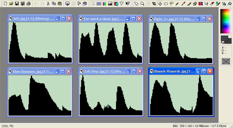

hi folks,
a funny little program which introduces to speech recognition by the NXT.
Actually - it's of course not speech recognition, it's more "Rhythm Detection".
Construction: Sound Sensor at port S2.
- different oscillographs from spoken words

new version with oscillograph (revised version) :)

Are the graphs with our without a German accent?new version with oscillograph (revised version)
