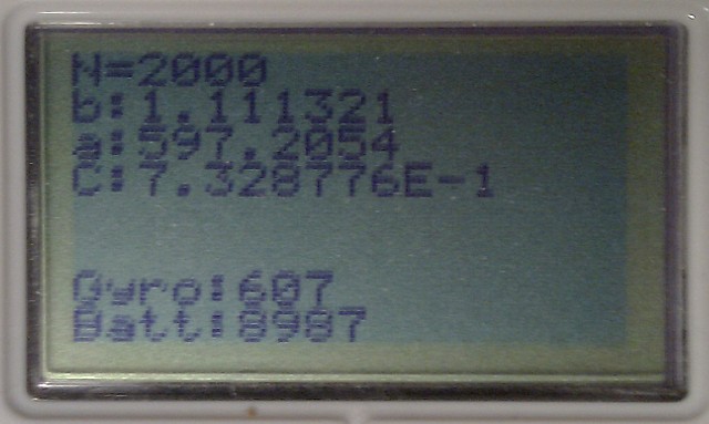

I then created a small program for the LEGO brick to take some samples:
import lejos.nxt.ADSensorPort;
import lejos.nxt.Battery;
import lejos.nxt.Button;
import lejos.nxt.LCD;
import lejos.nxt.SensorPort;
import com.kvols.stat.Stat;
public class GVSampler {
	public static void main(String[] args) throws InterruptedException {
		Stat stat= new Stat();
		ADSensorPort gyroPort= SensorPort.S1;
		gyroPort.setType(SensorPort.POWER_9V);
		for(;;) {
			LCD.clear();
			LCD.drawString(stat.toString(), 0, 0);
			int key= Button.readButtons();
			while(key == 0) {
				LCD.drawString("Gyro:"+gyroPort.readValue(), 0, 6);
				LCD.drawString("Batt:"+Battery.getVoltageMilliVolt(), 0, 7);
				Thread.sleep(50);
			if(key==Button.ID_ENTER) {
				LCD.clear();
				LCD.drawString("Sampling...", 0, 3);
				for(int i=0; i<100; i++) {
					double batt= Battery.getVoltage();
					double gyro= gyroPort.readValue();
					batt= (Battery.getVoltage()+batt)/2;
					stat.add(batt, gyro);
					Thread.sleep(10);
			if(key==Button.ID_ESCAPE) break;
The brick was then attached to a DC power supply, and 20 iterations of 100 samples was taken from approx. 5.5V to 9.5V.
The result is quite similar to the results from Aswin:
Battery/Gyro offset correlation
For my sensor at this temperature, the approximate sensor offset would be:
offset= 597.2054f + Battery.getVoltage() * 1.111321f
The correlation of 0.733 does indicate that there are other factors at stake here, eg. sensor noise, battery sensor noise. But still: It's probably a much better way of eliminating at least some of the sensor noise and get a bit more predictive results!
I'll keep you posted when I have a new version with the battery voltage taken into account!
Povl
