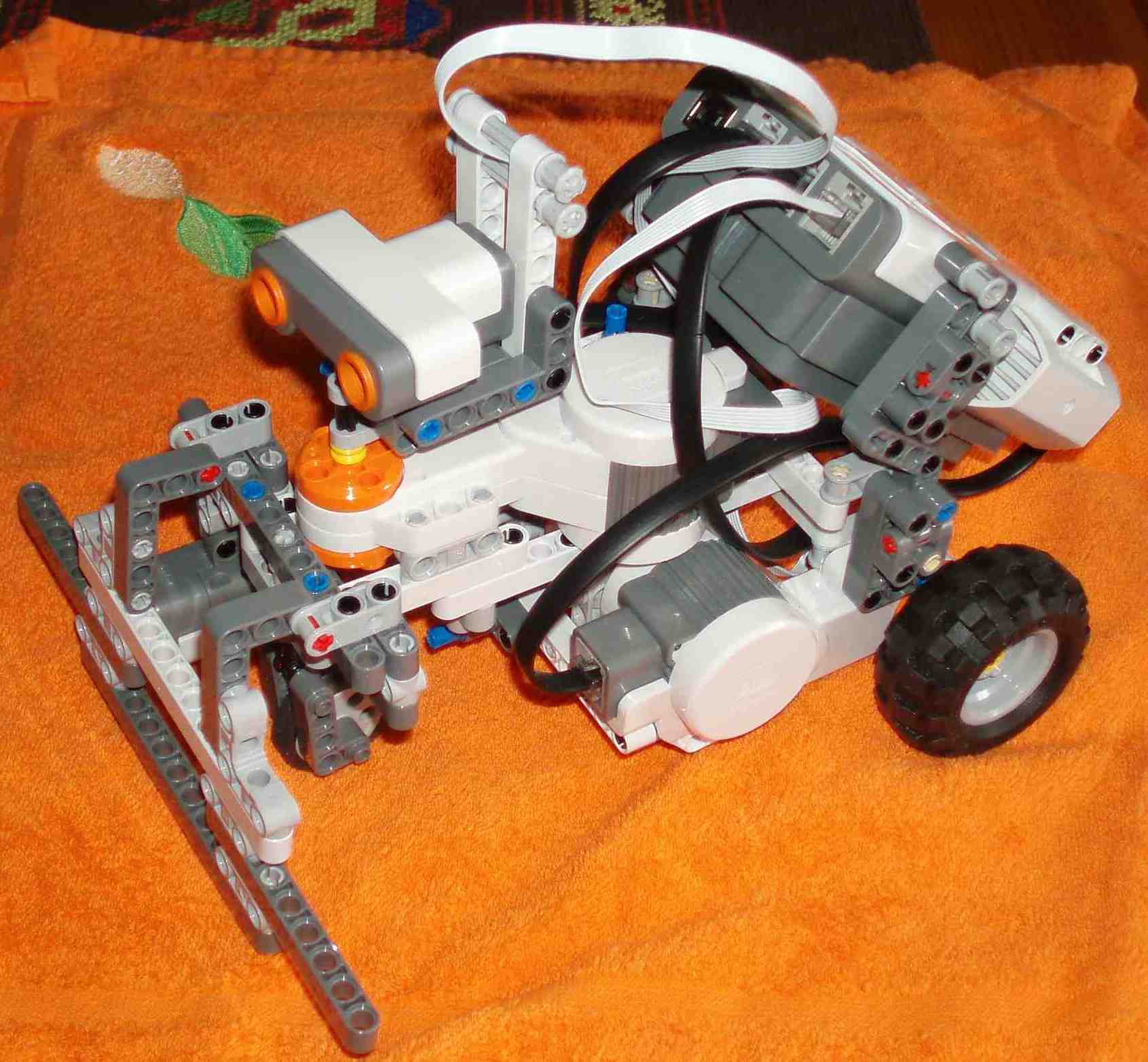

Could I also ask you for an image of your robot and your compass mount?
I'd happily send you an image of my wander robot, but I'm too much of a newbee to even understand all of what the FAQ about posting images was trying to tell me.

Here are a couple of pictures of my robot. The compass is mounted about 22cm above the NXT. I have used a ball as a caster, and with the rubber wheels there was no noticeable slippage on my tiled floor.
I took a fair amount of care with mounting the caster wheel to ensure the compass was as horizontal as possible.

Thanks for the photos.
Any tips on making images a little smaller?

rghansen wrote:Thanks for the photos.
Use Picasa to resize them. That's what I do. It's free. Artweaver is another great free image editing program.
