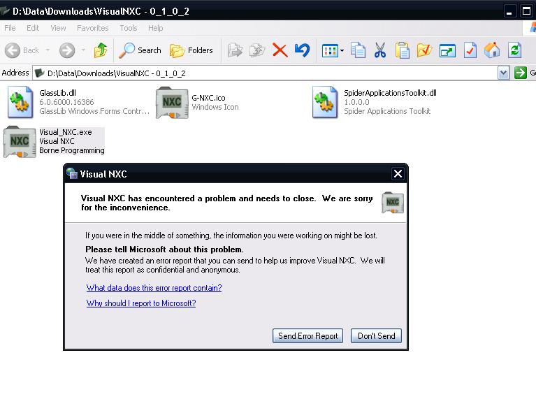

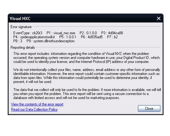

Re: Idea: Visual NXC
it crashes on my XP SP3 when I run it.
a few seconds after i click the .exe it gives a dialog box (in picture)
screenshot
screenshot
screenshot2
screenshot2

timpattinson wrote:it crashes on my XP SP3 when I run it.
a few seconds after i click the .exe it gives a dialog box (in picture)...
Interesting... Is anyone else with XP getting this error?
is it because i am a "Power User" not admin
It works for me with Aero disabled on Vista. (I bet it looks better with Aero enabled, but since 99% applications don't really "need" Aero like Visual NXC uses it, I keep the memory hog disabled.)

Tim: That shouldn't be an issue.
muntoo wrote:It works for me with Aero disabled on Vista. (I bet it looks better with Aero enabled, but since 99% applications don't really "need" Aero like Visual NXC uses it, I keep the memory hog disabled.)
Yes, but the problem is that XP doesn't actually have the DLL's that control Aero. Even when it's off, Vista still has the Aero DLL files.
