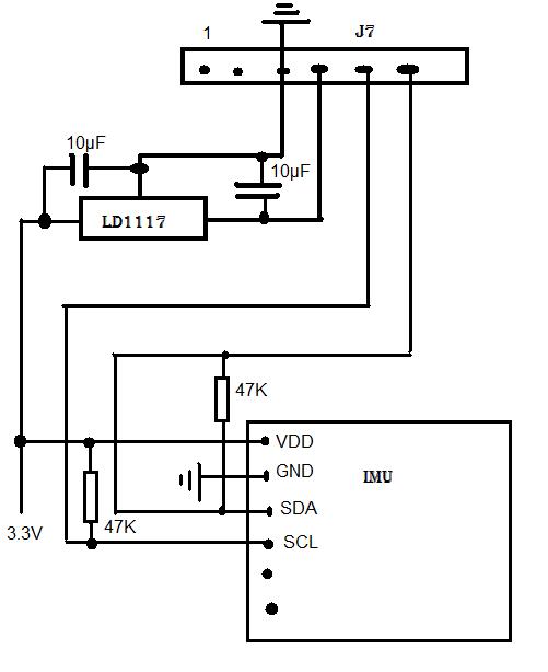

An update on the progress thus far.aswin0 wrote: I haven't got this sensor working. Therefore I have decided to get some experience with a simpler device first. For this I bought a blinkM all color led. It is also I2C device but it works on a wide power range. First I will try to get this sensor to work on 4.8V. Once I got that working I'll try to get it to work on 3.3V. if that works I'll swap it with the IMU.
I got the blinkM led working, first on 4.8V and now on 3.3V. From this I conclude that the wiring must be ok, that the 3.3V power supply must be ok, that the pull ups must be ok and that my software must be ok.
Then I took my new IMU unit, removed the resistors from the board, soldered some pins on it and swapped the blinkM for this IMU and started testing again. No luck whatsoever.
Next step is to call in the bus pirate. Any suggestions for a good terminal program for windows?
I need a break, advise and encouragement.

Hi aswin,
Sounds like you are having fun. What sort of terminal program do you need? Does it need to talk to serial port? I tend to use putty a lot and I think it can talk to serial port but I've never used it that way...
If you have the time (and can be bothered) I think a circuit diagram of how you have things connected to the board would help us understand how you now have things configured... Is the IMU a new one or is it the same one you used for your previous tests? Do you have any way of checking that you did not damage it it with the previous experiments?

Re: Custom I2C sensor problem
Sure I'm having fun, I won't be discouraged that easy.
It's a new IMU that I used today (because I'm not sure of the old one). I can test the IMU using the bus pirate I bought, but then I need a terminal program and I need to master the bus pirate, this won't be overnight I guess.
Here is the scheme I use. Note that I removed to resistors from the IMU.
