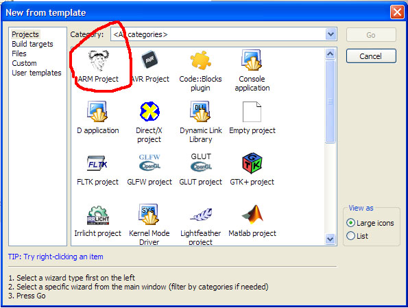

muntoo wrote:
  • NEW: Which [free!!] compiler shall I use? :)
For what?
The FW, or stealing their code?
I know you can create an ARM project in Code::Blocks, with gcc
Maybe if would work better with IAR embedded Workbench (free 128kb limited version, for the nxt), which the Lego devs used
