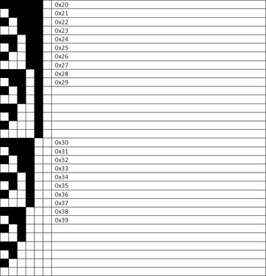

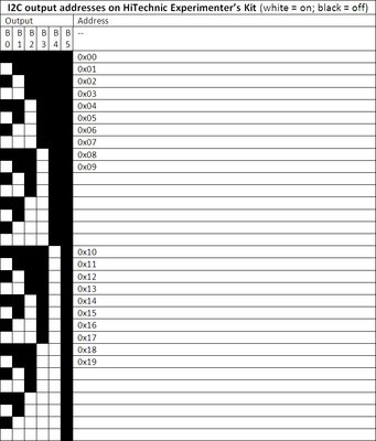

Hi there,
I recently got the HiTechnic Experimenter's Kit, and I've got it set up withsix LEDs connected to the output pins (B0 - B5) on a breadboard. i was trying to turn them on in different ways using one of the example programs, but I can't get some of the combinations, like turning the first four on, for example. So I wrote down all possible combinations, and tried to get them. Turns out I can't get 24 of them.
The attached images (they might also show up below, if everything works) show all the combinations I could think of, with the I2C addresses next to them, if I could find them. My question is (surprise surprise) if it's possible to achieve those other outputs and how?
Possible combinations vs. achieved combinations 1
Possible combinations vs. achieved combinations 2
Thank you in advance,

dimasterooo wrote:Hi there,
Unless I am missing something obvious, the 'missing' values are 0x0A, 0x0B, 0x0C, ..., 0x0F and so on.

yep, that was the problem. Thank you! Address 0x00A, B, C, D, E, F got the first six, 0x01A, ..., F, got the second, 0x02A, ..., F got the third and 0x03A, ..., F got the last; they were even in order! I've got images of the new list attached below (can't paste the whole thing here because it's too long :/). If it's helpful for anyone, I can post a link to the full image.
thank you guys,
