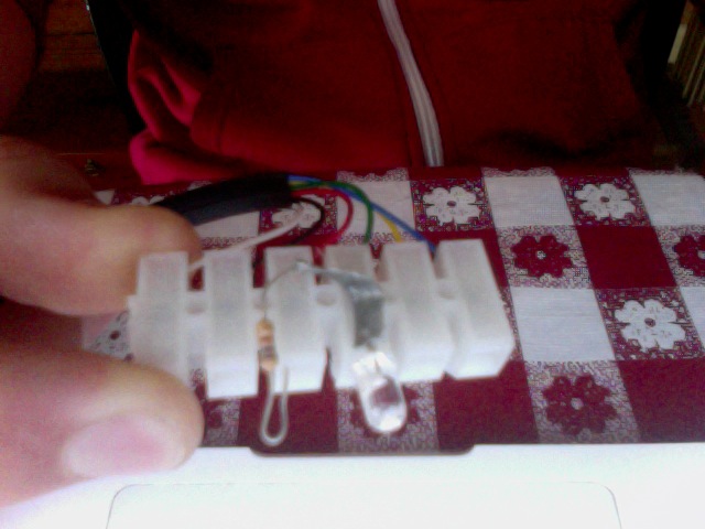

I have an IR transmitter hooked up to my NXT
I am running a very simple program to turn the transmitter on and off:

To ensure that the transmitter is working, I am using my phone camera. Indeed, the transmitter is working, but it is not turning off...
Does anyone know why this might be?

Re: IR Wiring
How is it wired?

Green 4.3V wire --> IR Transmitter --> 560 Ohm Resistor --> Ground (Red)
fuzzball27 >>-->
Re: IR Wiring
The green one is always powered (when the NXT is on). It is the sensor supply voltage.
Pin 5 (yellow) is the control pin used for the light sensor. It is turned on and off to control the light. You should use a transistor to handle the power though.

Thanks! I'll give it try :D

It's working great! Thanks for the help.
