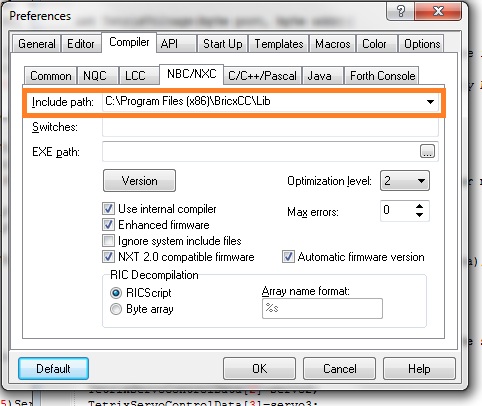

Muntoo, I think you missed my point. You do not have to save the libraries (or "myblocks.nxc") in the same directory... you can make the compiler look in an additional directory (where all the libraries or whatever else is located). It keeps me from have a zillion duplicates all over the place. It also means I only have to modify it in one place, and everything get modified.muntoo wrote:...Just put #include "myblocks.nxc" in all of your programs from now on. (And don't forget to put "myblocks.nxc" in the same folder as each of your programs.)

Re: My Block equivalent in NXC
How do you do that?mattallen37 wrote: ... you can make the compiler look in an additional directory (where all the libraries or whatever else is located).
