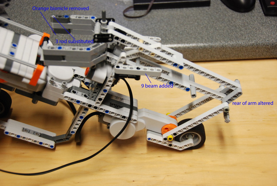

The other areas I have played with on and off for a long time is in trying to get Hans Andersson's tiltedtwister to work. There were some quite large threads on this on the nxtasy site. I have recently had quite a lot of success with the latest tiltedtwister 2.0 version which is designed on the NXT 2 set. Hans has updated the software, and I find that this now works reliably as far as reading the cube is concerned. I have experimented with altering the design of the arm a bit, largely after viewing the video shown here http://www.youtube.com/watch?v=rvAjDHOTiHQ
The author has removed the orange Technic Bionicle 1 x 3 Tooth with Axlehole, has added 7 hole beams to stop the Technic Angle Connector #6 just behind the ultrasound sensor from coming apart, and appears to have altered the positioning of the two Technic Beam 4 x 4 Liftarm Bent 53.5 at the end of the arm assembly.
I now have an arm which will solve slightly disarranged cubes, but it still has problems when the cube sticks and doesn't align properly after some twists. I am experimenting with lubrication, and also am trying to hack the program to add a pause (until an added touch sensor is pushed) each time the cube is released by the arm, so that any manual tweeks can be made. Has anyone else done this?

Below is an annotated image of my modified twister arm, based on fsalimen's youtube video. (twister225.jpg)
I have now also modified the program code so that it pauses each time a layer of the cube has been rotated, so that it can be manually adjusted if it is not completely square. Using this, I can now successfully solve any scrambled cube on my arm. I will now work on lubricating the cube, to try and get it to solve without manual intervention.

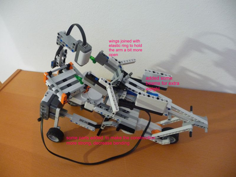

I am new to this forum, I don't know what everything had been posted to previous nxtasy, but I want to share my experience too.
I have been also exited about the TiltedTwister. I think, it is still one of the most ingenious solutions among all cube solvers made of Lego.
When it works, of course. The opposite was a reason of my little disappointment.
I build TT according to instructions. Used my twenty years old Rubik cube. The tilting worked fine but to twist was a problem. Also lubricating didn't help. I bought new one. Twisting works fine, but tilt fails quite often. Old cube weights 120g and new 100g. Twenty percent difference is
enough to settle down the cube correctly back to the cradle.
With help of test program - to test combinations of tilt, grab and release I tried to do some improvements. Some of them are also inspired
by the rbnxt post.
In the code I added GrabCube(); ReleaseCube(); after each Tilt();. It helps the cube to settle down into the cradle after not properly finished tilt. Takes longer to solve, but works much more better. But still not 100% reliable.

- Changes in the construction
- tt-charis-01.jpg (109.17 KiB) Viewed 21110 times
