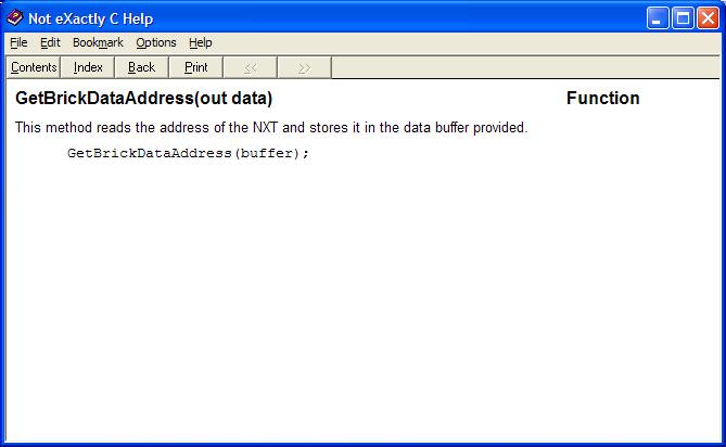

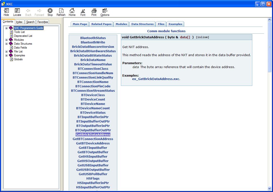

I can't tell whether running the .reg file made it so that BricxCC's help is now HTML or Win32.
HTML help:
(111.94 KiB) Downloaded 63 times
Win32 help:
Re: NXC command FreeMemory()
mattallen37 wrote: The help box(es) looks like the second picture "Win32 help".
You need to enable HTML help if your help content looks like the Win32 help image I posted. What happened when you double clicked on the .reg file with the content I posted above? It should have said something about merging the contents into the registry or words to that effect and asked if you really wanted to do that.

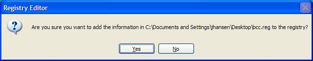

It did as you said, it asked if I was sure..., and I told it to, then it said something to the effect of "done" (with more words than that).

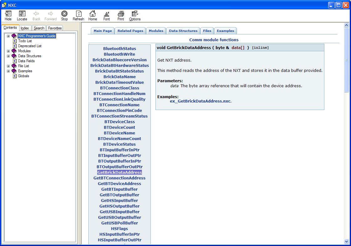

Once you have run that .reg file and it says that it added the information into the registry then any subsequent running of BricxCC and asking for help should display the HTML help contents rather than the Win32 help contents. Please run BricxCC and post a snapshot of what you see when you press F1 on the word "task" or "GetBrickDataAddress" in an editor window.
