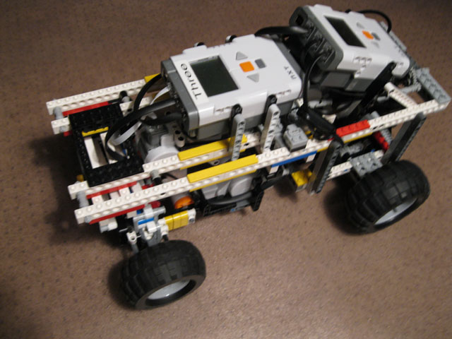

				Here is something I built to use the new "big" wheels I got. They don't look all that big anymore...
Mechanical characteristics:
It is four wheel drive. Because of the difference in the wheel diameters, I use different gear ratios. According to my logic and math, the gear ratios should be very well matched for the wheels. I can lock/unlock both differentials using driving rings. It has 5 NXT motors (4 for driving, and one for steering), and one PF medium motor (to lock/unlock the rear differential). I have to manually lock/unlock the front differential. I used an interesting design for the front "rocker". It tries to keep level. It is not like using a single point for the tilting, it uses multiple crossed beams, causing it to behave in a very desirable manner.
Program information.
It is remote controlled using the PSP-Nx and a playstation 2 wireless controller. I used RS485 for the "master" (front NXT) to tell the slave what to do. The master controls the front drive motors and the steering motor (it uses APR for the steering
). The slave controls the two rear drive motors, and the differential locking motor. I implemented my ramp up/down motor control for "smooth" driving (I have control over the ramp rate with the controller).

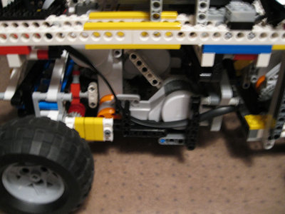

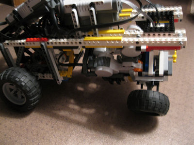

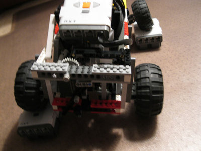

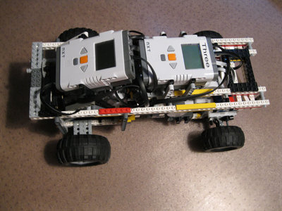

Here are some pictures of it:
The front assembly:
Note, there is a 3 attachment limit per post, so I plan to make another post (or two) for some more pictures.

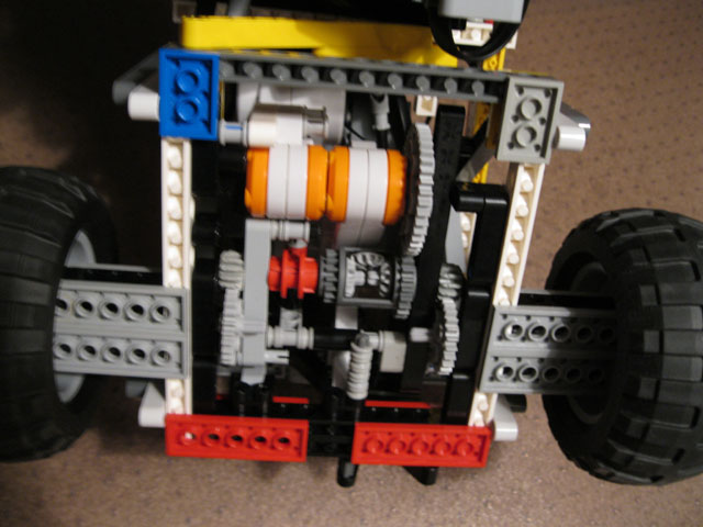

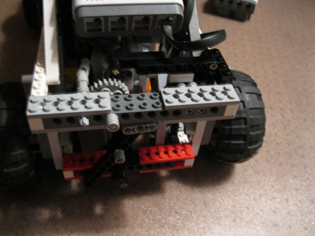

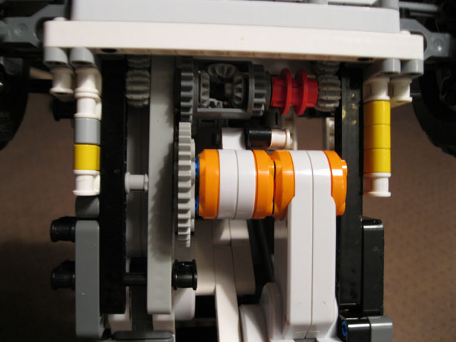

				Here is a picture of the rear gearing, and differential locking driving ring.
Here is a picture of the front gearing, and the differential locking driving ring.
Here is a picture of the back, showing the rear differential locking mechanism the motor uses to lock/unlock the differential.

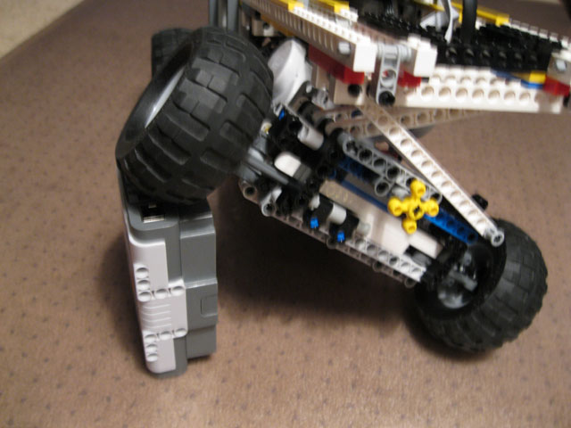

				Here is a picture of one of the front wheels resting on an NXT:
Here is a picture of it with the other front wheel on the NXT:
This picture shows it resting on two NXTs:
The vehicle is powerful enough to drive up the wall until it is totally vertical (coming from an angle, so the front wheel "grabs" the wall). It can drive up and over a 3-5 inch (10-16L) vertical stone side with no trouble. It can roam across a pile of 1" wood cubes.
