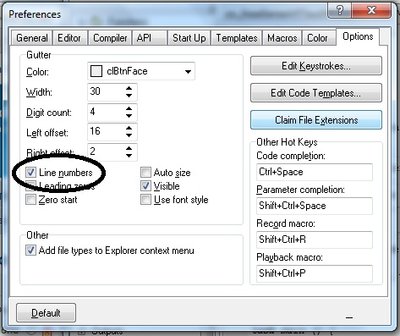

For line numbers, open 'Preferences', click on the 'Options' tab and click on the 'Line Numbers' box.

As Matt mentioned, you can turn on line numbers in the gutter via the Preferences dialog on the Options tab.
Choose the &quot;Line numbers&quot; option on the Options tab to turn on line numbers in the gutter.
Choose the "Line numbers" option on the Options tab to turn on line numbers in the gutter.

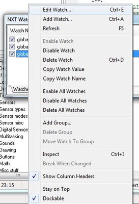

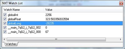

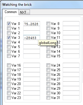

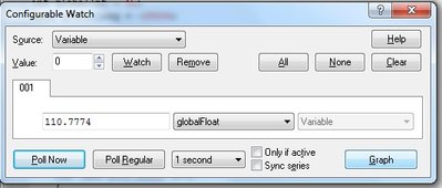

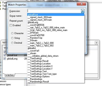

All three of the variable watch tools name the variables something other than var1, var2, etc... Here are some screenshots.
hints on variable fields in the original watch window
The variable name shown on the configurable watch tool.
variables watches in the new NXT Watch List tool
Watch list popup menu options
Watch properties dialog with drop down list of variables
I'd love to have some help documenting all three of these tools more fully.

I find the NXT watch list most convenient
however, i cannot find the variable i want to watch in the drop down expression list.
what if i just type the variable in the expression space; will it work??
