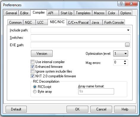

I am trying to use the tachometer in the motors for odometry, yet when I use cos or Cos (as i have tried them both) I get a file error message on the nxt lcd screen. I already have the enhanced firmware checked on the compiler options, any suggestions on how to fix this or work around it will be appreciated.

When you get the file error message is there any sort of numeric code shown as well? If not, that would indicate to me that you don't have the latest NXT 2.0 compatible version of the enhanced NBC/NXC firmware installed on your NXT. Also, the compiler options screenshot indicates that you do not have the latest version of BricxCC installed. I recommend updating to the recently released version of BricxCC (i.e., not just the test release zip). The version is 3.3.8.8.

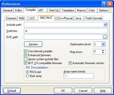

With the latest version of BricxCC you can also enable an "automatic firmware version" option on the NBC/NXC tab in the Preferences dialog. This will override the "default" options for the firmware version based on what it detects that you have installed on your NXT. If you try to run a program that requires the enhanced firmware on the standard firmware then you will get File Error messages. That seems the most likely cause for the error you are getting.

It will report the error you mention (to my knowledge) only if the default settings are configured for the standard NXT firmware. I recommend checking "Enhanced firmware", "NXT 2.0 compatible firmware", and "Automatic firmware version". Oh, and "internal compiler".
