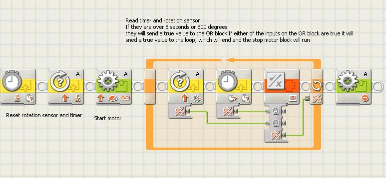

I s it possible to control the time and the degrees that the motor turns in NXT-G? I mean, both at the sametime?

If you mean like eg.. move for 500 degrees or 5 seconds - whichever the shortest -- you could do something like thislargofang wrote:I s it possible to control the time and the degrees that the motor turns in NXT-G? I mean, both at the sametime?
