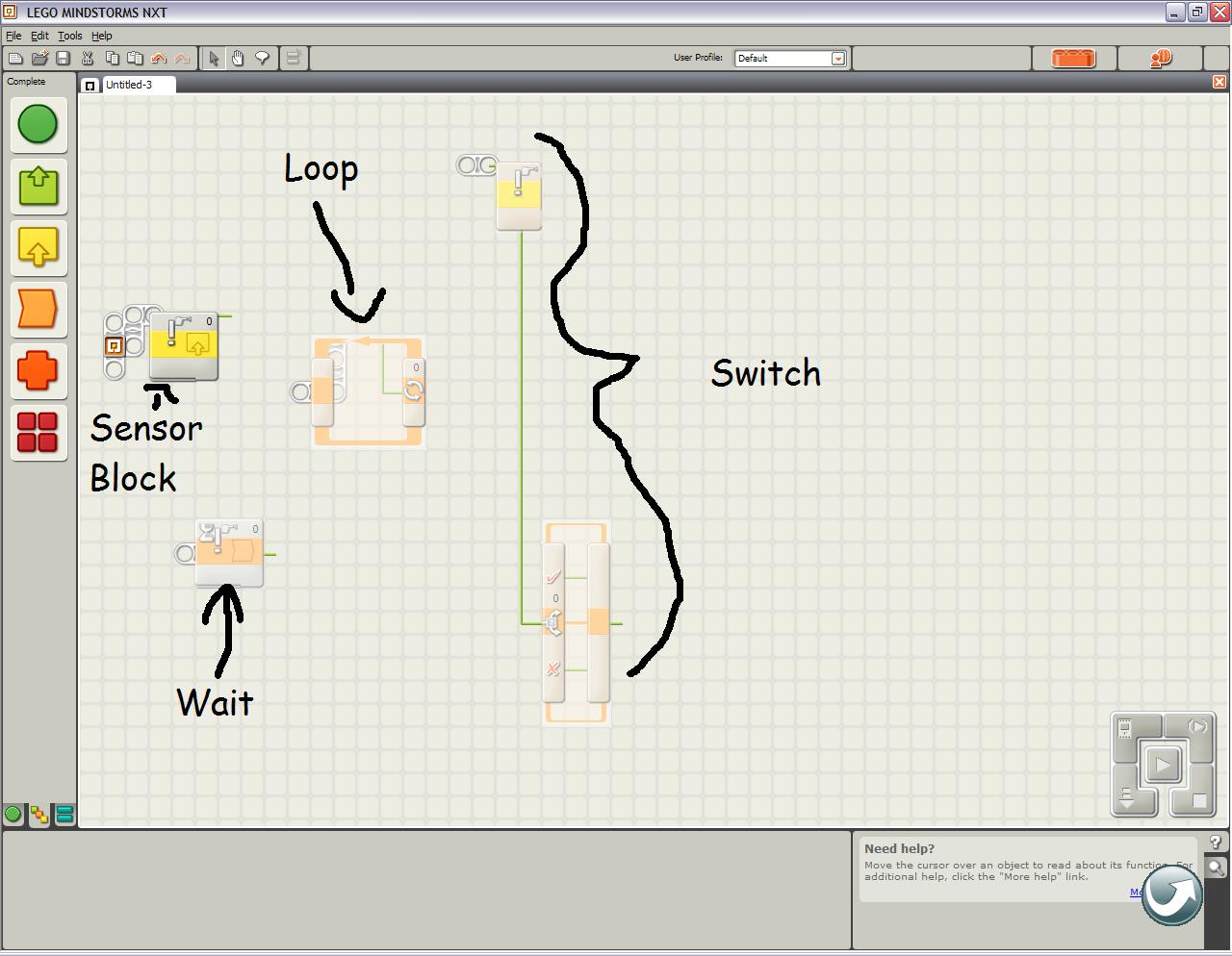

I tried making a NXT-G block for a sensor that I made, but when I imported it, the sensor block and its loop, wait, and switch blocks would look weird. (see attached picture) I have included the files that I imported to NXT-G.

The problem is that you removed the "Sequence Flow" items from the main .vi, so the sequence beams (in NXT-G) have no place to attach.

Thank you, I just copied them from a template sensor block
