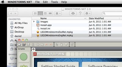

Success with installing on Mac OS X - Lion, after following this:
1) Download the ISO file, double click to open
2) Don't click the Install.app file instead click LEGOMindstormsEngRet.mpkg
I'm still miffed and amazed that Lego shipped a DVD in my kit that had NO Mac files on it at all.
- screen shot

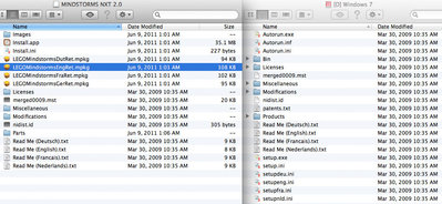

FYI, here's a comparison on the left-hand side showing the files and folders from the Lego download link and on the right-hand side the DVD that shipped with my MINDSTORMS NXT 2.0 kit:
- Comparison
