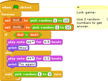

Java Exception:
Class: 78
Method: 482
PC: 33318
Sad. Well, i still get errors. I am very familiar with Scratch, the program you "templated".

Hmm.... Can you e-mail me your file or export an image of your code and attach it here?
You are using LeJOS v0.85, are you not?
Clinton

The Java nxj FW is : Version 0.85, Menu version 0.85!
Yep.
Screenshot 02
Screenshot 02

Hmm... It appears my luck is different.
I ran the program as-is for five minutes and always got "Try Again!". I finally removed the wait loop and shortened the time the try again note plays, and pretty quickly got "Wow!" answers, too. Did the error message come up right away for you?
I don't see anything wrong with the code. It certainly appears to be correct. Which of course leaves me grasping at straws. Possibly reflashing the LeJOS firmware on your NXT would make a difference, but it does unlikely.
Would anyone else try recreating dudmaster's program and reporting back?

I'm not worried about the program, it always gives me the error right off.
