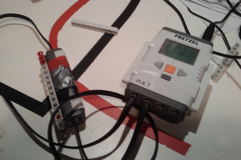

My results are quite surprising. I used the setup in the image below. An NXT 1.0 light sensor in ambient mode and the colour sensor facing it. I made sure the space between the two sensors was quite well insulated from outside light. I had an average measured raw value on my light sensor of about 23, which is really quite low, so I was pretty sure not a lot of light was coming in.
I measured the time it took for the light to turn on and for the light to turn off using RGB, Red, Green and Blue mode. All times are measured in ms.
Mode   ON      OFF
RGB    139     17
Red    320     122
Green  319     122
Blue   319     122
I have no idea why it takes longer to switch on and off in non-RGB mode. Let me know if you get similar results.
