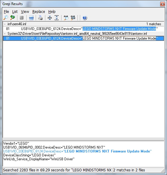

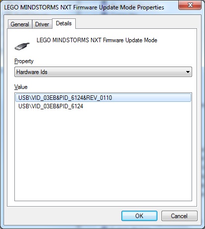

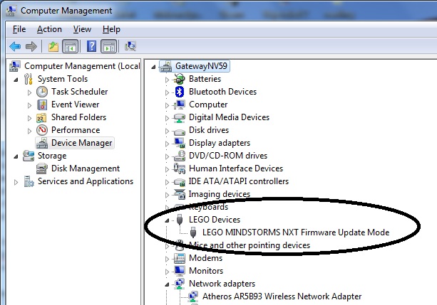

aagruntpuddock wrote: If you search Google you will find it has been a very big problem for many people for a long time! Some even had to return their bricks to Lego to get them sorted.
Clicking brick syndrome is not at all the same thing as your NXT clicking in SAMBA mode. A brick clicking in SAMBA mode is very much a normal state of affairs for the NXT when it is waiting to download a new firmware image. Is it possible to panic in this situation and thoroughly screw up your machine when your NXT is in this state if you read scary information on the web and don't really know what you are doing? Yes. Should you scare other people away from flashing their firmware with horror stories about how hard it was to get yours working again? Absolutely not. Is flashing a firmware image completely safe and without any risk of damaging your NXT? No, but it is usually foolproof and more than safe enough that the benefits far outweigh the risks.
I tried both the NXT-G and Brick Center several times but neither could connect to the brick. Tried restarting the computer, resetting the brick, deleting then adding the brick back in through the devices manager but to no avail.
BricxCC will say that it was unable to connect to the brick when it is in SAMBA mode. That is completely normal and expected. Will you be able to compile and download programs to the NXT in SAMBA mode? Definitely not, but if you look at the Tools menu you will see that the Download Firmware option is enabled. On my Windows 7 64 bit system with the correct version of the Fantom drivers installed I have never had a problem with BricxCC installing a new firmware image on the NXT that has not been immediately fixed by simply repeating the firmware download process a second time. The latest test release of BricxCC should be even more robust in this regard and likely will rarely, if ever, fail on the first download attempt. Usually a failure only occurs due to the plug-and-play found new hardware toast popping up and Windows configuring the driver for the NXT in SAMBA mode.
One thing I would recommend is never try to download the firmware if your NXT is connected through a hub instead of directly to one of your computer's powered USB ports. A lot of different USB devices have been known to have problems being correctly recognized by the operating system if they are underpowered due to being connected via an unpowered hub.
When in SAMBA mode the NXT should be listed as a LEGO MINDSTORMS NXT Firmware Update Mode device. See the screenshots below.
No other vendor should be using the 03EB vendor ID that belongs to ATMEL. And there should not be any other drivers installed on your system that match the combined 03EB vendor ID and 6124 device ID for the NXT in SAMBA mode. http://www.linux-usb.org/usb.ids lists the combined vendor and device ID as at91sam SAMBA bootloader. In device manager it should show up as using the winusb.sys driver. The connection to this driver should be specified for the 03EB vendor ID and 6124 device ID in the fantom.inf file that was installed on your system when you correctly installed the latest version of the Fantom drivers from the LEGO MINDSTORMS support page.
Here's the correct driver link:
http://cache.lego.com/upload/contentTem ... 7C537F.zip
It is far more hazardous to fiddle around with drivers in your Device Manager when you don't know what you are doing than it is to flash a new firmware image on your NXT using BricxCC. You can very easily get your OS into a state where it won't recognize a USB device or it will think it is a camera and you'll have to resort to running XP on an old Dell laptop.
In summary, if you ever hear your brick clicking and it appears to not power on then first make sure you have the latest Fantom drivers for your OS installed then connect to a powered USB port on your computer then run BricxCC then click OK when it says it can't connect then choose Tools|Download Firmware and browse to a .rfw firmware image (standard or enhanced) and download it to your NXT.
If you have confused your OS about what driver should be used for the NXT when it is in SAMBA mode then point it at the fantom.inf file on your system. It should configure it as a LEGO MINDSTORMS NXT Firmware Update Mode device using the winusb.sys driver.
