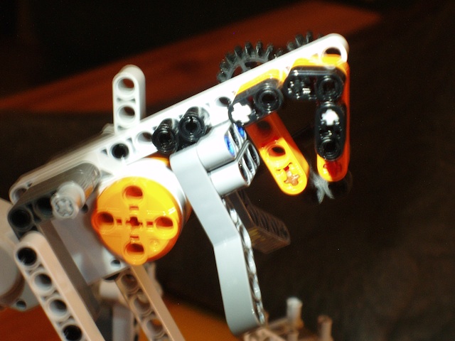

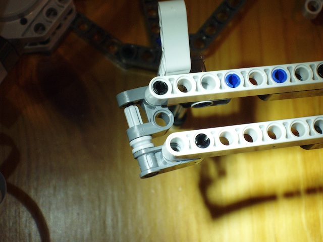

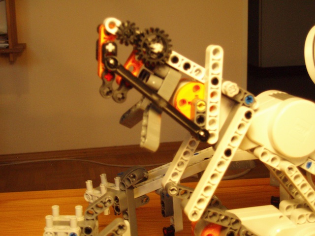

After much trial and even more error, I've finally come up with a set of almost useable photos:
This one shows the 3-beam added near the top of the arm alignment fork to stiffen it
3-beam added to top of arm alignment fork
The front side of the arm with the connector rod connected to a 3-beam instead of directly to the motor to allow for more clearance between the connecting rod and the rear finger. I also changed the back stop for the 3-beam from a small 2-beam to a 7-beam (I had run out of 5-beams). This gives better linearity when the fingers close on a ball.

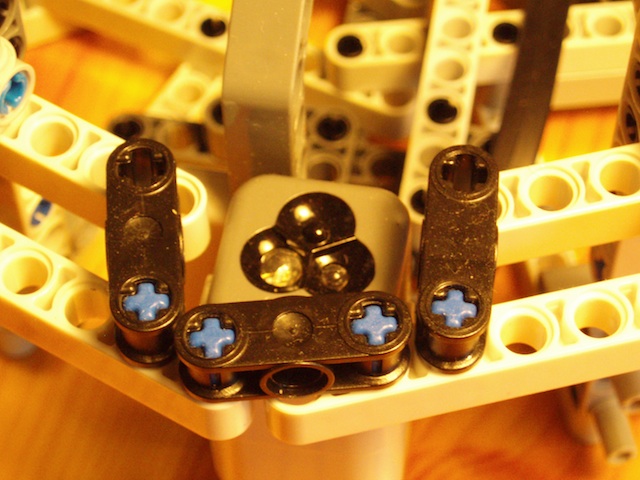

I'm including just one more photo to show that if given enough time, I can actually get one of these fully automatic digital cameras to focus on what I want.
It is a closeup of the light shield. The 3 black beams sit on top of beams that are suspended from the two stands on either side of the color sensor.

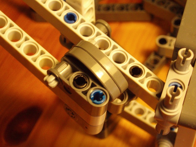

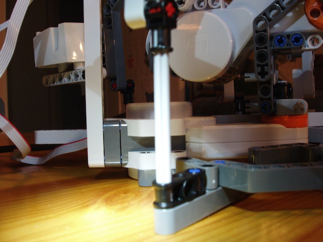

Thanks for the photos. I think you may also have altered the bottom end of the ball chute where it meets the first stand. Can you give any detail of alterations here? For example, it looks like you've used two 13 beams instead of the 13 plus 11 one specified in Philo's original design. I can't quite see the detail at the bottom end on the video.

You have a good eye.
I used a 13 for the simple reason that I had run out of 11s. But this also let me easily connect it to the nearby stand to stiffen both of them. I'm not really sure whether this was necessary or even beneficial. This is a critical area of the design and I spent a lot of time adjusting the spacing between the bottom ball holder and the alignment pin.
I connected the rails together with the following construction which allowed me to easily adjust the rail spacing. If the spacing is too narrow, the balls tend to fall off, if it's too large, they get stuck.
I also moved the top of the rail in 1 hole. At higher speeds, the balls tended to bounce off the inner rail and jump over the outer rail.
