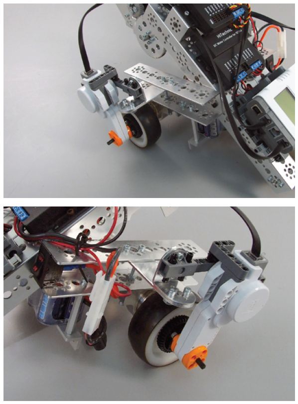

Here are a couple pictures you may find useful:
Re: NXT motor: use as an encoder with removed motor?
thank you, I know these pictures, and of course I would attach the Lego "motors" as encoders (without motors ) exactly this way. But with motors still in the housings the friction is too strong.
