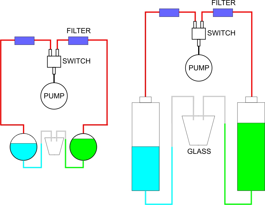

Re: Need help with my latest MOC
Revised layout
What's the filter?
What's the filter???h-g-t wrote:Revised layout

In an earlier post, doc222 was concerned about lubricant from the switch contaminating the product -
I suggested sticking car fuel filters in the airlines to pick up any particles.Just a thought here but you do know that these pneumatic switches come with a lubricant inside that well, I would think is not for human consunption. Silicon ized chocolate milk yum yum. even the tubbing if not designed for human consupton can be hazardous. other isuues will be left over milk in the parts after the first day will rot, using this more than once...... you have the posioninator

One issue about the lego switches at least with air: when they pass center they release the air from the pressure side, is this leaking milk?
Yes...but if I use two separate outputs for each bottle, it shouldn't......should it?doc222 wrote: One issue about the lego switches at least with air: when they pass center they release the air from the pressure side, is this leaking milk?
Probably, unless you loop the output tubes up as I show in the diagram. Once the vacuum is released then there is nothing to stop the fluid from running out.
